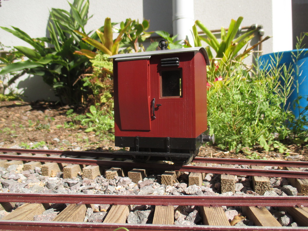

Might as well throw mine into the hat..
I built mine back in 2016, almost certainly lurking on this thread for reference. Figuring a guard's van wouldn't be out of place on most trains, I cut down an IP Rheidol kit, to make something vaguely based on the Innisfail Tramway's guard's vans.
The body and chassis are fixed together via the couplings' mounting studs. The axleboxes carry the wagon's weight in the usual manner, taking care to ensure no part of the mechanism touches the chassis or body, and enclosed the "machinery" from the bodywork to help prevent the body from becoming a sounding box.
It hasn't had a whole lot of use, as for the most part I've had nowhere to run. At around 800g it's quite effective, as we've come to expect of the Zecar.
Here it is running on an indoor test loop years ago.
I've plans for another two momentum wagons, as rakes of sugarcane trucks don't have guard's vans attached. Ordered the Zecars from the US four months ago, and by now can only presume they've been lost somewhere. I've just contacted them about re-sending the order.. One of them will become a navvies' tool wagon, based on this ex-Moreton sugar mill example now stored at ANGRMS. I don't remember what I had planned to build with the other mech.
