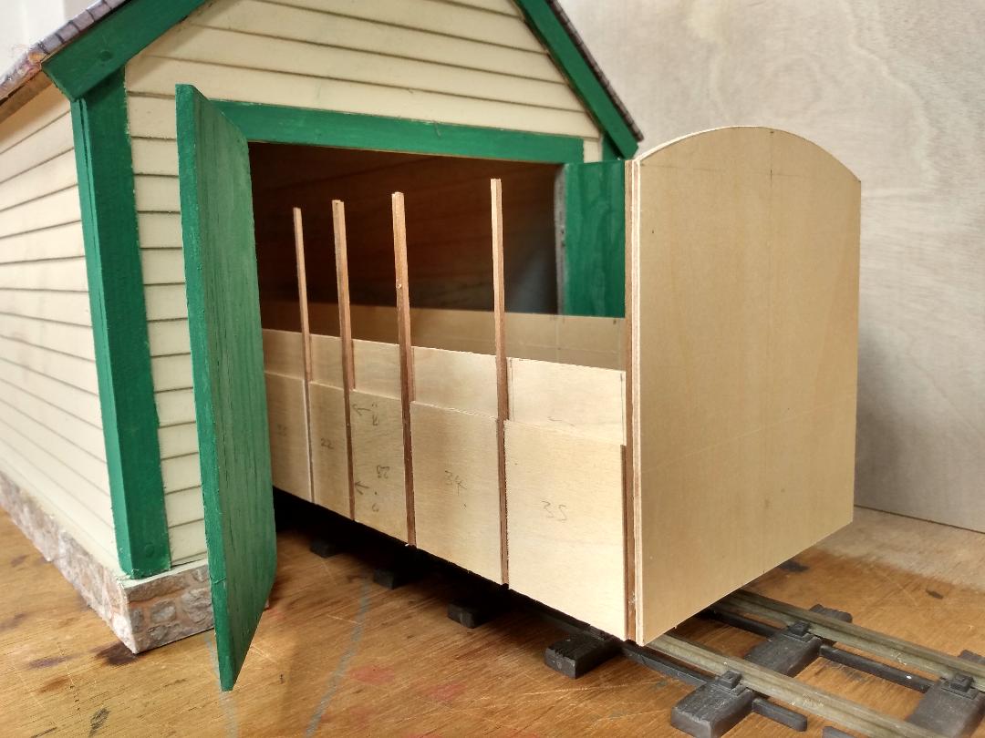

Thanks! I probably did fluff the MDF, but I stuck a thin veneer of ply over the top - if you look closely you'll see the ends are slightly thicker than the sides... I think I'll get Phil's model of an early FR coal wagon too...JMORG wrote: Sun Aug 09, 2020 8:05 pm Looking good Andrew!

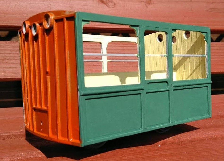

Before I was distracted by wagon-building, I'd observed that a somewhat clandestine operation was taking place in the railway's carriage and wagon works...
Strolling past the works today I discovered that a little more construction has taken place - after some weeks, finally the end is in sight. Not a lot else, just the end, plus a few rather spindly-looking uprights with some spacers between them, but it's progress, I suppose...
Unusually, work on this "mystery carriage" is taking place from the inside out, with the internal walls being added first.

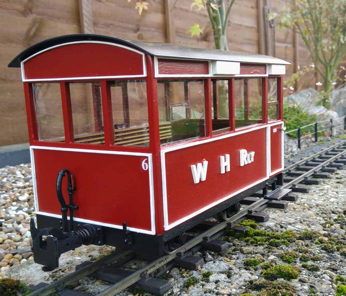

Modern WHHR carriage 6 in the current livery. Was unsure at first how it would look but now I think it looks great.

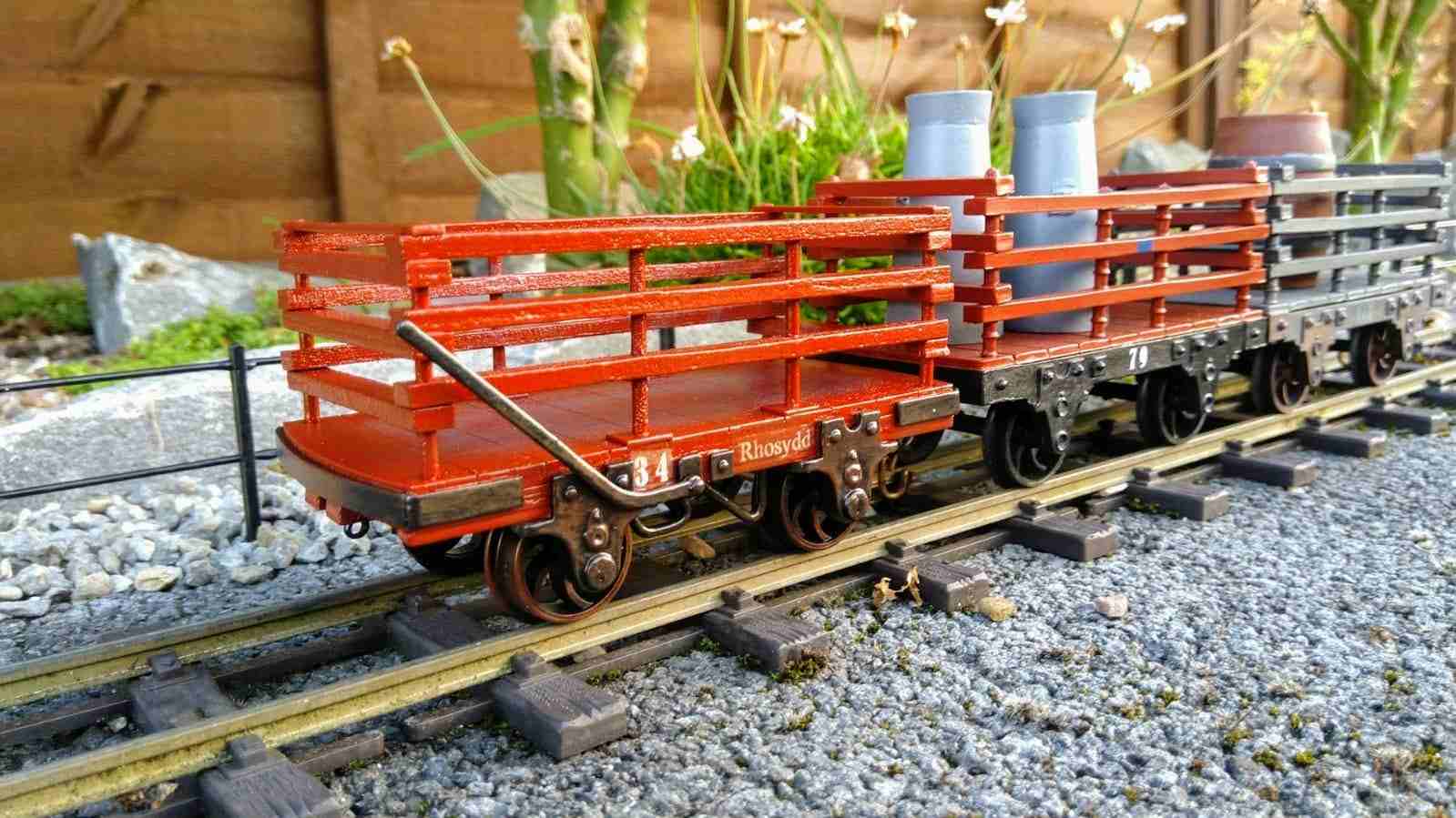

Lineside Hut Oakeley quarries coal waggon. I've cut 5mm from the top and bottom to get it more to the correct height.
Lineside Hut Slate waggon; modified to look more like the Rhosydd quarry waggons. Note the differences between it and the Binnie behind.

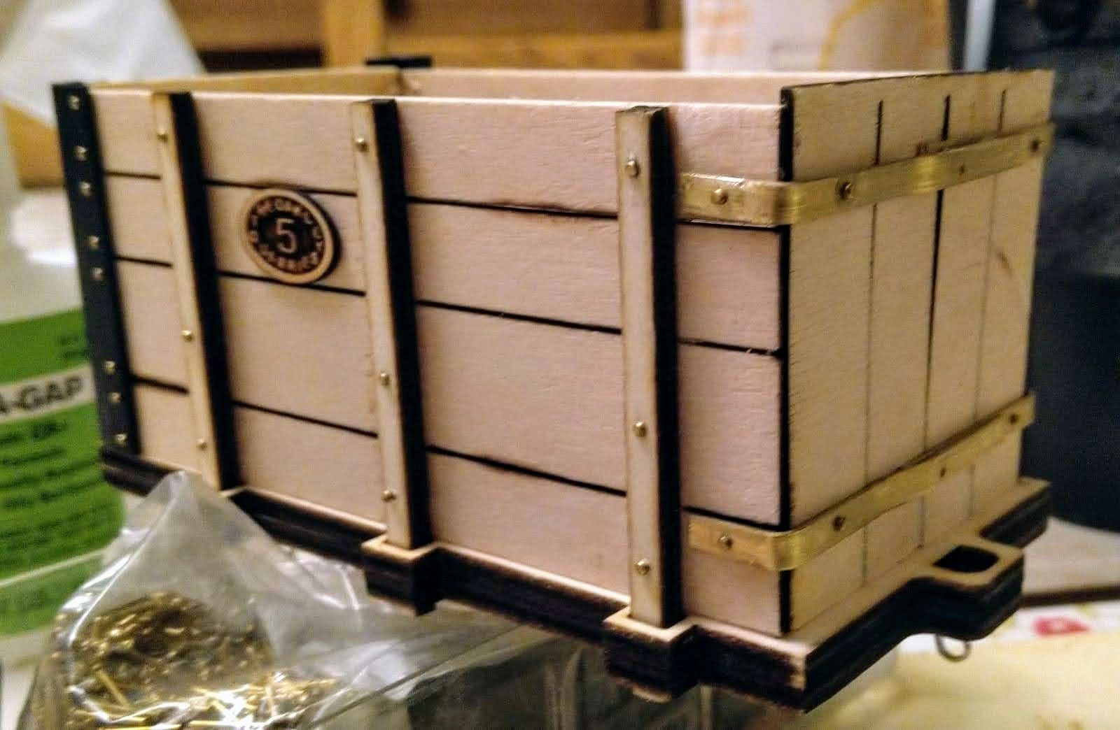

I've been cracking on with some modelling myself recently, principally with another Phil Sharple kit, for an early FR coal wagon this time. I never seem able just to take a kit from the box and build it as per the instructions, and this one's been no exception... Firstly, I turned it inside out, so that the planking detail's on the inside - now stained with my usual vinegar and wire wool mixture. I've added new veneers of 0.5mm ply to represent the planking on the outside, which will enable me to sand back the paint for my favoured well-worn look. I've added a metal (well, plastic) plate over the curved buffer, and nail gem rivets over the etched ones on the strapping overlays. I think I'll put it all together and paint it next (although possibly not in that order), then I need to think about adding brake gear. Here it is so far:
