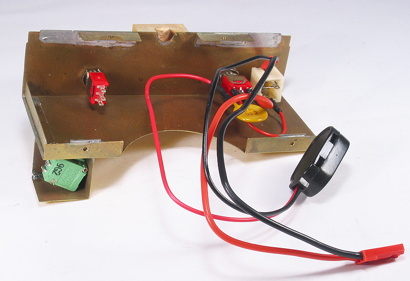

The first job was to remove the manual speed control and rewire the loco control panel. The result is shown in the photo.
The old speed control pot and reversing switch were replaced with bits from the scrap box to maintain the cab appearance, as the original speed control was disguised as the handbrake and the reversing switch was masquerading as the throttle. Reading left to right, the little green object is the dud potentiometer, then the old switch, then the existing charge/run switch and finally the charging socket on the right.
The yellow disc under the charge run switch is a PTC resistor. This is a solid state device that limits the current drawn from the battery to a very low level once tripped, but will reset when the high current draw is removed. Cheap protection for the expensive battery and ESC.
The old motor and ESC connections were replaced with JST plugs and a new battery clip was fitted. The control panel and cab were then refitted to the chassis with the new leads fed through a suitable opening at the bottom of the cab front. The three plugs are the battery connector, the JST-M plug to connect the motor to the ESC and the JST-F plug to connect the power from the charge/run switch to the ESC. The next photo shows this arrangement.

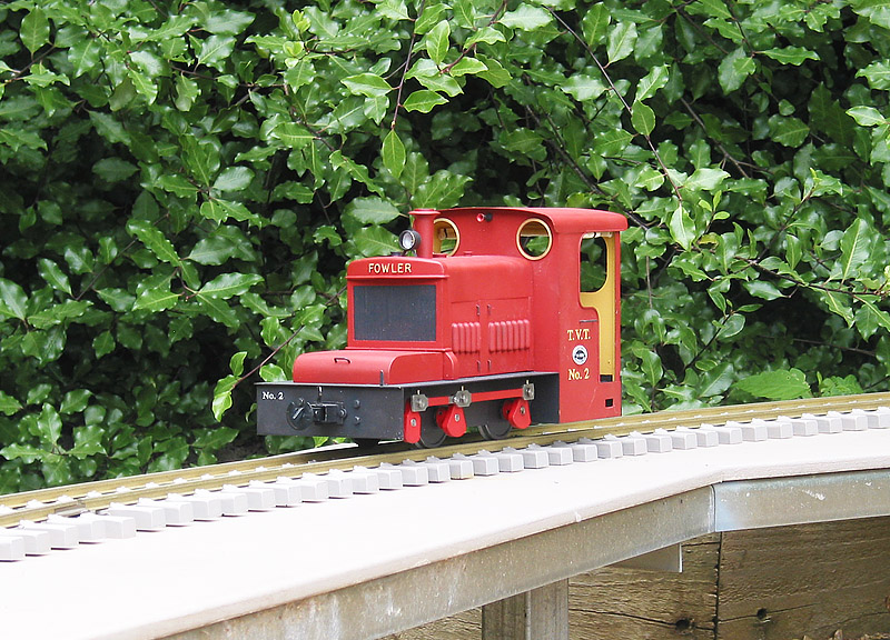

The last photo shows the loco running a light engine test on a gloomy afternoon in Melbourne. The loco doesn't run any better than it did with manual control, but I don't have to bend over low to the ground to access the controls now, which is getting more difficult to do.

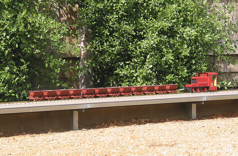

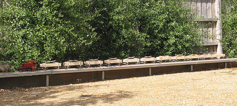

Just to give you something to look forward to, these photos were taken earlier this year when I was testing the new track. I ran all the rollingstock around a few times to make sure there were no issues with the turnouts and the then manually controlled Mule was rostered.Mitch stack wrote: ↑Sun Dec 15, 2019 8:04 am Seeing this making me even more Tempted to buy myself a Fowler
Running a civil engineering train. The v-tippers are Binnie kits.
Running on the timber tram (it thinks it is a Kelly & Lewis diesel....). This train is all the timber bogies on the line and it just walked away with them.

Impressive hauling power.
