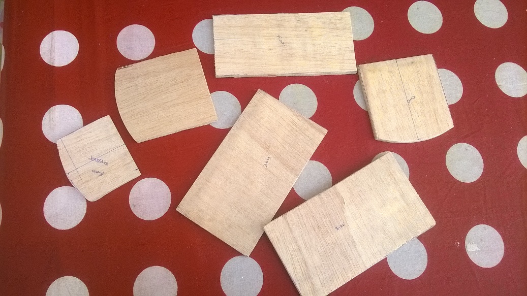

I've made a start on the next (WH)WHR rolling stock project, goods an number 2:
I'm currently without a closed van while WKLR van 11 awaits repairs to damage sustained through being stored in the tunnel, and anyway it's time I got back to building genuine NWNGR/WHR vehicles...
I've got no fewer than three drawings of this van, all different, but analysis of photos has resulted in a version I'm happy enough with. It's really quite a small vehicle, but that's because it's just a coal wagon with a few added planks and a corrugated iron roof...
Here are the basic bit, hacked rather badly out of 6mm ply:
These bits will just form a basic shell, with individual planks and other details added over the top.

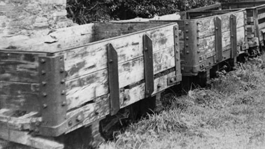

In the foreground are the bits for an open wagon, like one of these:
These little wagons were used for both slate and general merchandise - I'll probably build three of them eventually. For years I've been put off trying to recreate them because of the unusual axleguards, quite unlike anything available commercially. I think I've come up with a cunning plan there - more to follow, if it works...
