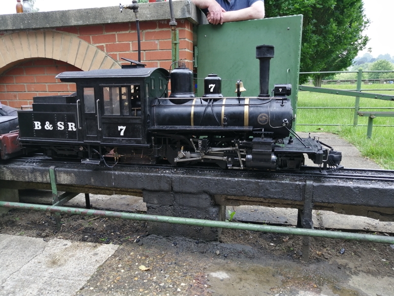

I went along today to the model engineering society I hope to be a member soon and there were a couple of 5" narrow gauge looking locos I though you all might be interested in seeing:
'Lucky 7' below is 3 1/2" and dwarfed in size everything running today!
I had not considered this gauge before, however, after seeing this one I would if something second hand I liked came along.
idlemarvel
Re: Larger scale Stuff
Post by idlemarvel » Sun Jun 23, 2019 5:55 pm
Very nice. The 3 1/2" gauge American outline loco looked the part. Is this the gauge you were thinking of?
Post by tom_tom_go » Sun Jun 23, 2019 6:11 pm
Hi Dave,
'Lucky 7' certainly does look the part, one of only two made by the same builder. The one I saw today was apparently the 'first attempt' but looked great to me!
I am looking at 5" gauge, however, narrow gauge in 3 1/2" is bigger than I thought it was so could be an option.
