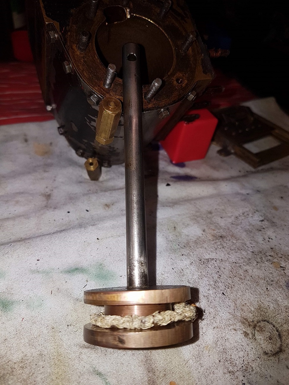

Some of you may remember that I acquired a 5 inch Railmotor last year and then a 3 1/2 inch Mountaineer. I did not really want the Mountaineer but it was being reluctantly sold by a member of my local club as the elderly owner could not keep up with much needed maintenance. It was also built by another club member and since its construction 35 years ago it had always been in the ownership of members of the club. A friend and myself decided that it needed to stay local because it always had been in the club and so that the last owner could still have use of it. We decided to pool resources to purchase it for a winter project. (I also found out later that the individual I bought it with knew that I was in need of something to get me out of the parish for a few hours a week in order to retain my sanity. This was his idea of how to help.)
It was in rather poor state, it had been partially stripped down and then given up on. Amazingly it did still run before it was stripped. There was a lot of play in the motion, the wheels were worn and it was leaking steam badly in a number of places. The state of the piston packing was interesting to say the least. However, the boiler was still in test which was perhaps the most important part.
New piston were fabricated and new rings were made out of PTFE and new phosphor-bronze bushes were fitted to the motion, the wheels were turned on the lathe as well. Much to our surprise the rest of the engine was in remarkably good condition. A few fittings will need replacing but work is progressing well. I can't claim to have done all the work on her, three or four hours a week does not allow for much progress, but I have done my bit, learned a lot on the way and thoroughly enjoyed the experience. More importantly it has allowed me time to get away from the 'phone and the doorbell for a bit, this has proved worth its weight in gold.

Novel piston packing!

The piston packing was a nice bit of possibly asbestos string 35 years ago. It was by this point past it's best.
