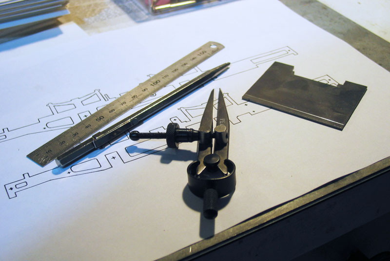

Marking Out.
You are halfway there Steve.......
One way to make a scribe line more visible is to use a wide marking pen to cover the area with black ink, then scribe. The 'correct' way to do it is to use Marking Out Blue, which is just a blue ink, but you can't buy that in the local newsagent like you can marking pens. You could always use a blue marker to make it look more professional I suppose......
The pic below shows my usual marking out tools on the metal working bench. A 4" pair of calipers, a scribe and a 6" ruler.
The workpiece is a bit of 1.5mm hot rolled steel plate that has been draw filed to give a straight reference edge and scribed to mark out a 3.5mm strip. It's already got a dark surface, so the line scribed with the callipers is quite visible if you have plenty of light. If it was nice clean shiny cold rolled sheet, I'd have run a wide line of ink along that side of the workpiece. The calipers were set to 3.5mm using the ruler, then run along using the reference edge as a step to give a scribe line parallel to the reference edge. A few minutes with the piercing saw and a #2 blade, a bit of draw filing and you have a straight, flat strip with parallel sides.
The drawing shows the frames for my current project. I'd go crazy marking all that out on a steel sheet, so I just glue the paper image on a piece of steel sheet, drill a few starting holes and start cutting.....
