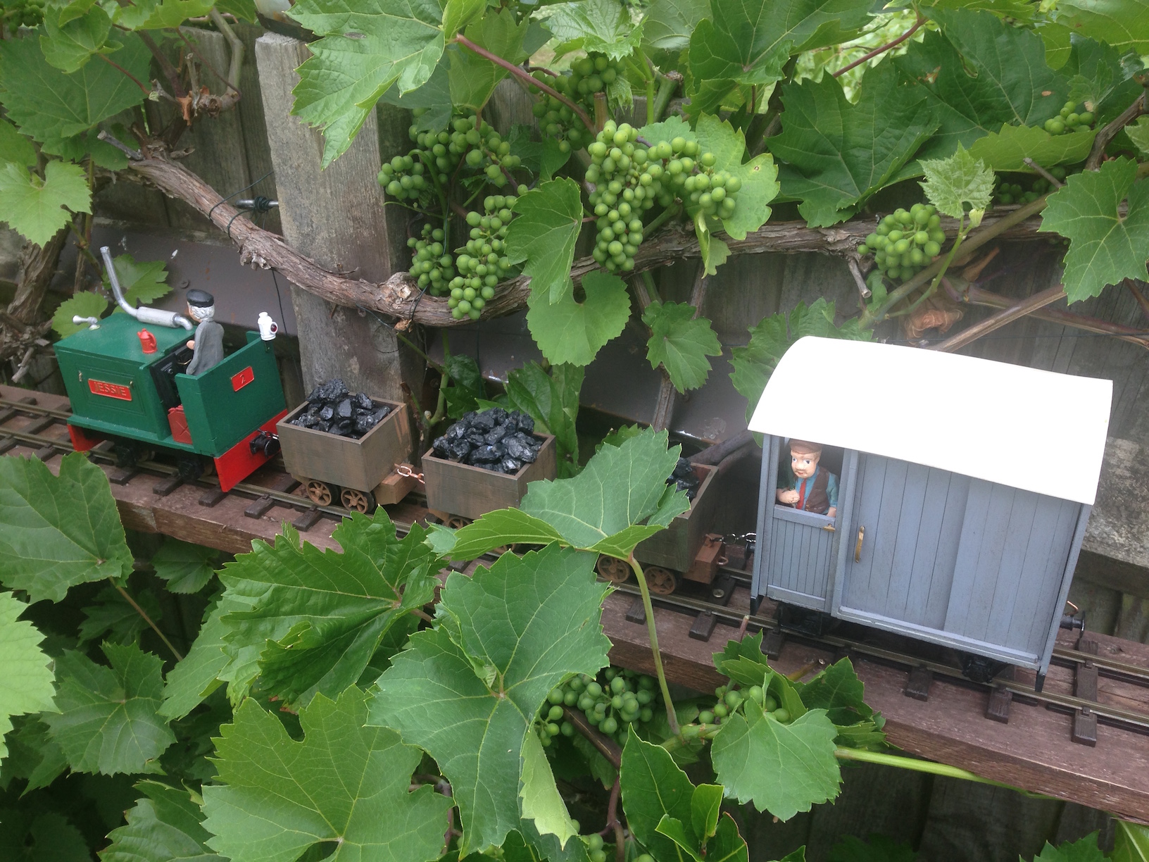

Cheers Jim - yes the grapes have done well - this year - we grow the vine for leaf coverage on a fence rather than for the grapes - the challenge is that in France , they might grow 10 - 12 bunches off each vine - on ours because it runs over 100ft along the fence, we've got probably 200 bunches, but they never gather enough flesh to be really viable - come September they are nearly all seed!
As you'll see from a more recent photo they are growing and the CHLR does have a vendage season, where we use the railway to clear all the bunches - I'll try nd take some pics this year!

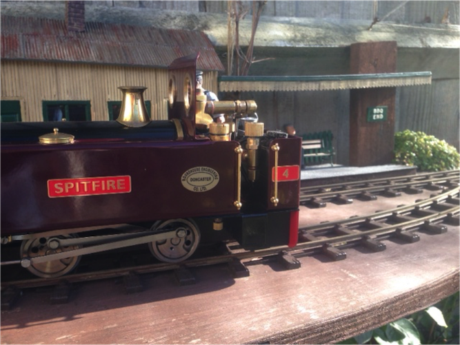

Just a quick update - videos to follow
Spitfire has now had remote control fitted by Matt at Barley Pit Works and he's done a great job - there are some photos below - the receiver and battery are tucked underwear and the driver stands proudly on the servo , virtually hiding it! No need for a cab or tender fitting which best suited my twisting industrial style line.
Its changed driving her from being fun but manically stressful if she took off to now being a slow speed enjoyable drive - she's rostered for the stopping service this weekend where as she normally has to run the express as stopping accurately at intermediate stations has not been possible
Will try and get some video up this weekend

Thought I'd share a couple of photos of CHLR's Millie at speed at the recent Kent 16mm steam up
Compared to the tight and gradient heavy CHLR, Spitfire was able to open her cylinders fully and get up to NG 'Main Line' speed - at times the safety wasn't blowing - which if you know a Millie means she was working hard - the momo wagon (disguised as a coal wagon) helps tremendously
I'm now adding more 'bling' in the shape of buffer beam overlays, more coal in the boot, step inlays - with cylinder covers and other upgrades planned
