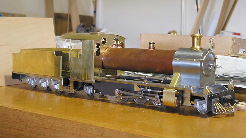

This pic shows the cab fitted in place. Clearances are tight, not helped by me building in 15mm:ft scale. By this time the cylinder covers have been fabricated to simulate piston valves and fitted. They look convincing from the front, but not so much from the rear. To improve the appearance from the rear would require new valves and valve chests so the valve spindle is in more or less the right place.

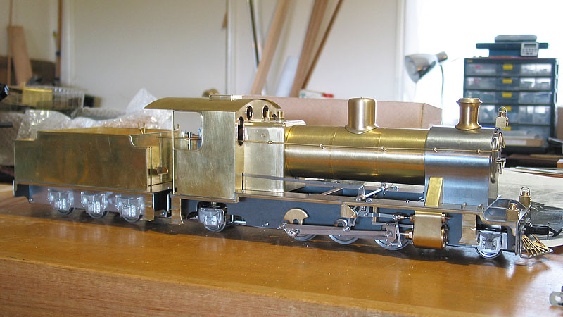

It now looks like a loco, but as mentioned early, the last detailing stage takes an inordinate amount of time. By late July it was completed and is sitting for it's portrait on a sunny winter day still in brass. Painting was put off for a while, as I wanted to do some work on the Garratt.
