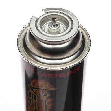

Note, these Argyle adaptors are designed to fit the 220g butane canisters used in camping stoves and widely available here in Aust. for around A$1.10 (equivalent to 65p) per can. These canisters have a plain 4mm dia. plain outlet of the type shown in the photo., the adaptors don't fit butane containers with EN417 threaded outlets, which I think are more common in Europe.
I've used Gordon's adaptors for years. They fit most of my locos, but I've turned up a couple of smaller diameter versions for use with locos that they won't fit......
