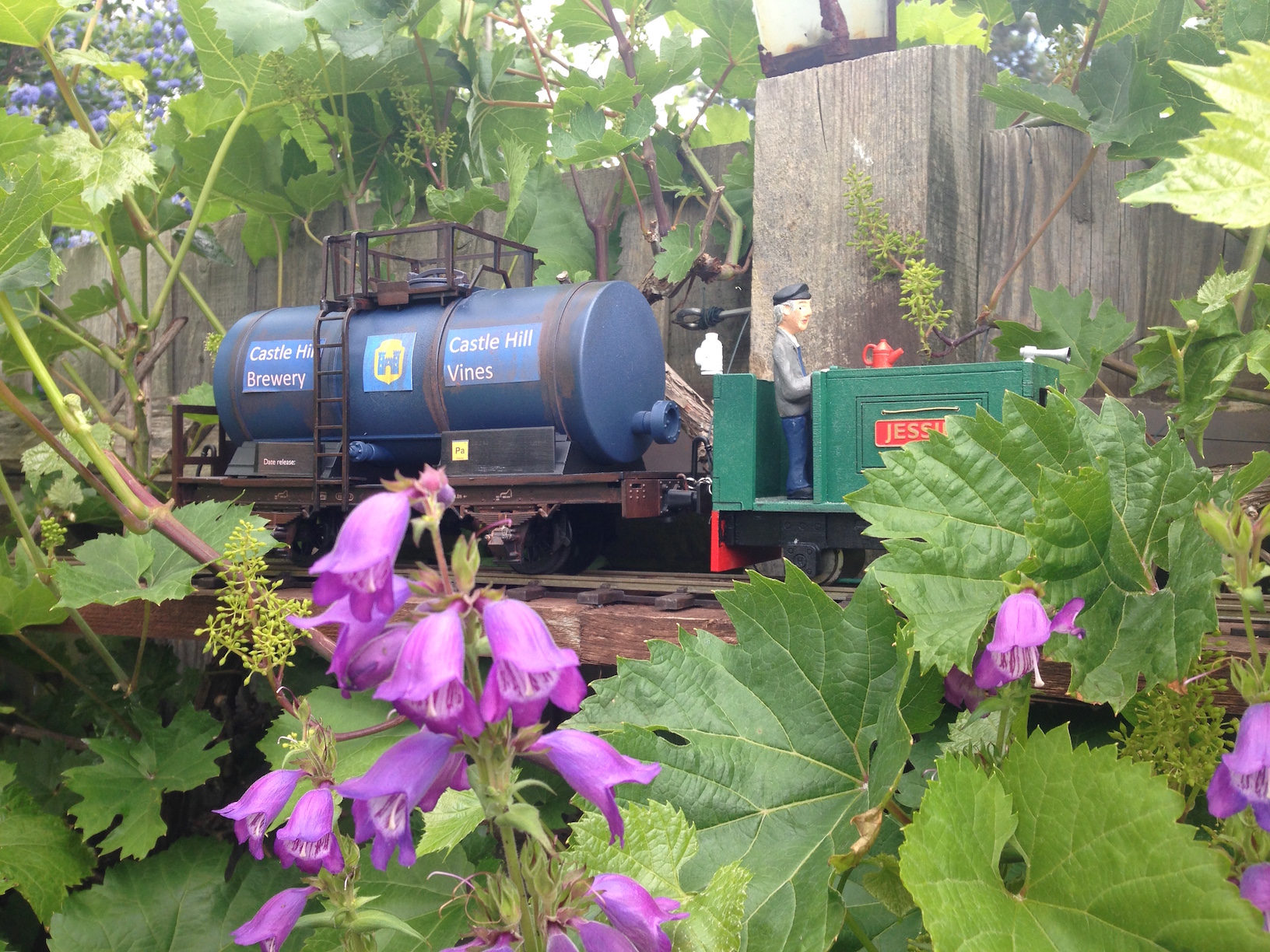

A little while ago I was thinking the soon to be built brewery on my line (well its operating in my mind, you just can't see it! ) needed a large tanker to move its beer down the CHLR to the Southern junction - where it can be pumped across to a standard gauge tanker and then taken up the smoke to the various Ale Houses the brewery supplies - well that was the back story
So I looked around and being fairly new to 16mm, I thought I'd have a go at bashing something rather than scratch building
I'd noticed these online on the old t'ebay
http://www.ebay.co.uk/itm/New-G-Scale-G ... 1366925074?
Well, with free P&P at that price, even if I dropped a right thingy ma-jig, I wasn't losing the crown jewels - so I paid my money and few days it turned up - it was a bit bigger than I imagined and its sold as G Scale - anyway against the Little John loco it looked quite good and those of you with Accucraft locos will find it fits alongside quite nicely.
So to work - firstly I ordered some 32mm wheels with the extra long axles to fit into the swivelling bogies
Next the buffer and coupling needed adapting to something more in line with what I use -the LGB hooks and loops were taken off and a simple hook was developed at each end so chains can be attached from the loco/next wagon etc

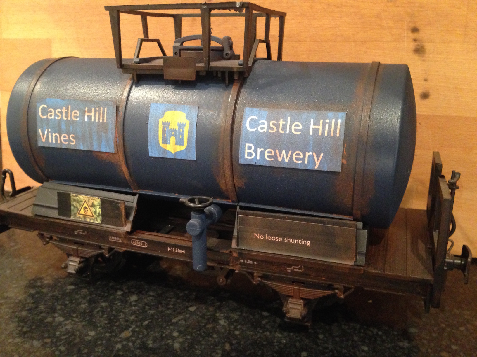

Then its a case of painting - the tank element is easily dismantle from the chassis and is formed of 3 parts - these were taken off, primed and then sprayed in a similar blue to the brewery logo I had developed.
The chassis was also painted and weathered (I also did the tank and all the fittings like the framing and ladder etc) - then on the computer I developed some new mini signs and notices etc more pertinant to the tanker carrying wine or beer instead of chemicals
And this is what we ended up with:- Out on line and a close up of the new chemical symbol I developed Overall i'm pleased with what was a simple conversion and it opened my eyes to the opportunities of bashing other 45mm items - you always have to check whether the chassis arrangement will allow you to fit 32 mm wheels but for most wagons its easy - I'm now looking at getting a couple of long flat bed wages for my winter kindling wood flows!

Re: Converted Tanker
Nicely done!
- Posts: 5296
Brilliant conversion Mark, great find. Impressive paintwork and finish too!
I can only second all of the above. Bashing can be a lot of fun.
