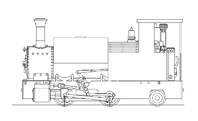

The project I started early this year was taking longer than planned and I decided I needed something quick and simple.
The plan was to use a Roundhouse chassis kit and a boiler kit to build a small tank engine suitable to work trains on the TVT branch line.
The initial design drawn up was for a simple 0-4-0 saddle tank, loosely based on the Baguley Kangaroo class. This slowly morphed into a 0-4-2ST based on the old Roundhouse Dylan design, which is shown in the sketch below.
