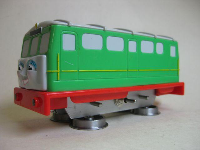

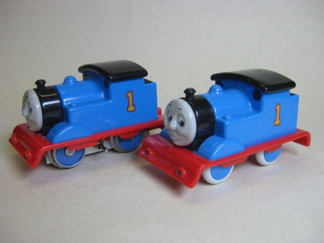

Photo 01. Two models of Thomas one of which has been modified into a battery electric and to run on ‘0’ gauge tracks.

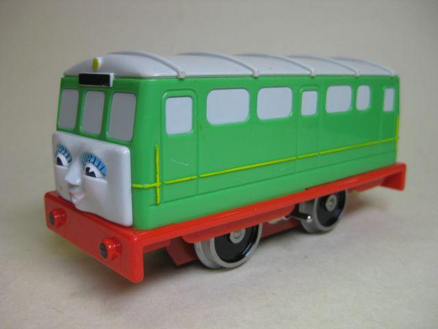

Photos 02 & 03. In this range of toys quite a lot of the Thomas the Tank Engine characters are available. Daisy which I believe is based on a BR Class101 being one of them.

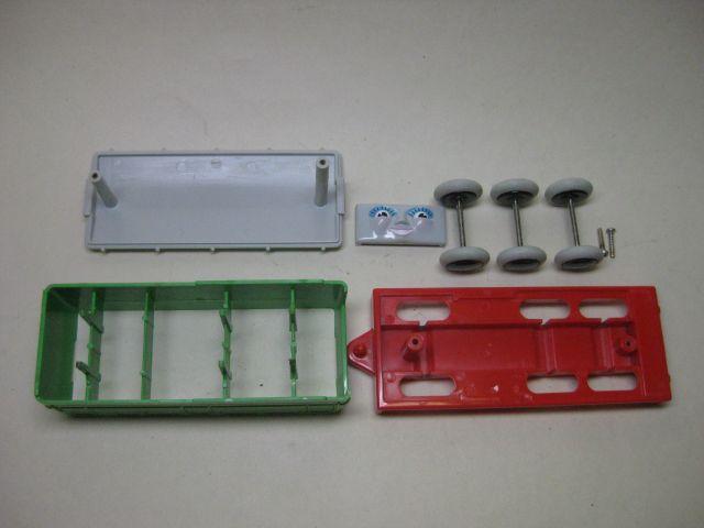

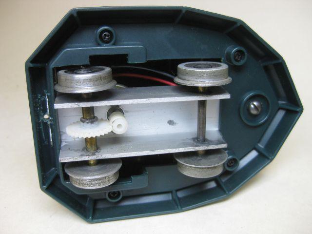

Photo 04. My model of Daisy has been in a draw since its purchase at a steam rally last September so it is about time she was modified. This range of models is held together with just two screws. Daisy undressed?

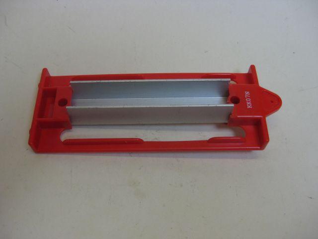

Photo 05. The first part of the modification was to cut out the unnecessary parts of the body and chassis. The screws being replaced by 3mm or 5BA threaded rod.

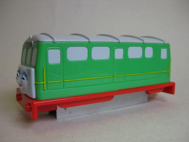

Photo 06. Trail assembly of the body and chassis. The roof has now been glued to the body.

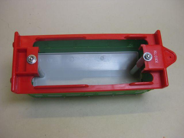

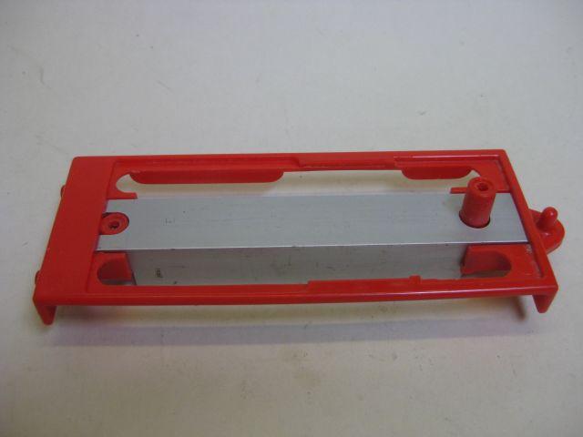

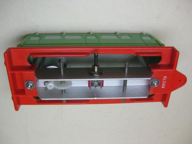

Photo 07 & 08. The metal for the new chassis is made from 20mm aluminium angle bought from B&Q and is so fitted that the coming together of the body and plastic chassis hold it in place.
Photo 09. Trial assembly of body and aluminium chassis.

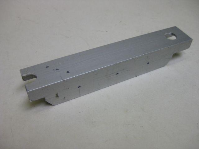

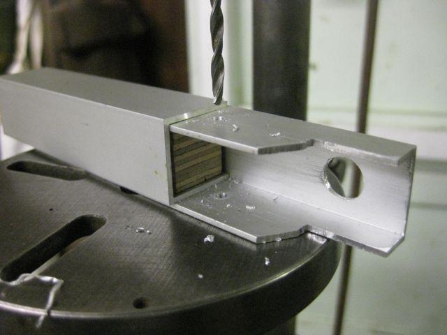

Photo 10. The new aluminium chassis marked out and spot drilled for the various components. Daisy should be a Bo Bo but as the model is a little short she will be a 0-4-0.
Photo 11. Jig used to stop the aluminium channel from bending while being drilled.

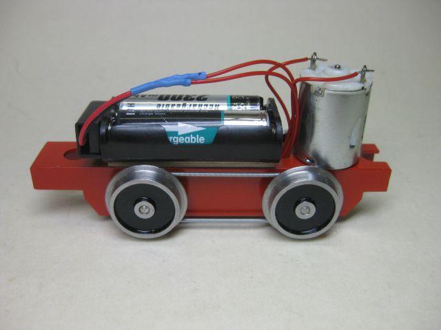

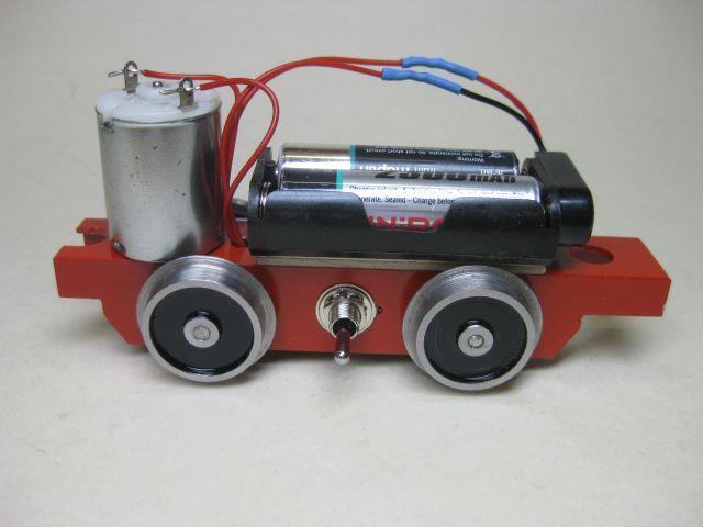

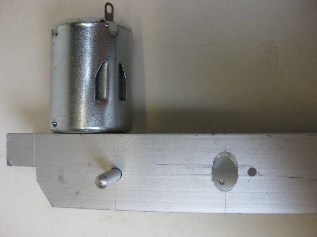

Photo 12. Electric motor fitted. The hole for the On-Off switch has been elongated to get the switch to fit.

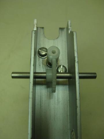

Photo13. Testing the mesh of worm and wheel.
Photos 14 & 15. New chassis fitted in the body which is as far as the modification has progressed.

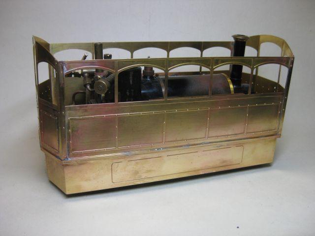

Quite right! I was soldering together an etched tram body kit and was a little tired of the Bakers Fluid fumes.

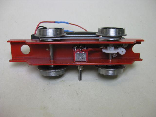

Yesterday except for making a cover for her gear box Daisy was finished.
There wasn't a lot of work left to do if she was to be single axle drive it would just be necessary to paint the chassis, push the wheels on and join up the electrics. It was decided to fit brass bushes for the axles, this was done because Daisy will get a lot of use at the CMES and fitting bushes makes it easier and quicker to take up the wear. Also she was made 4WD as the small layout she will mostly run on is only six yards long and goes up and down six inches.
Daisy's completed chassis.

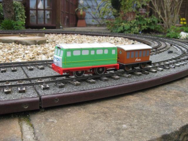

First test run of Daisy with our only item of rolling stock so far Annie.

Some of the chassis with their gearbox covers fitted, the holes in their corners are to aid in their removal. These covers are really needed if the model is to be used on a garden railway as with negative ground clearance the gears pick up all sorts of debris.
